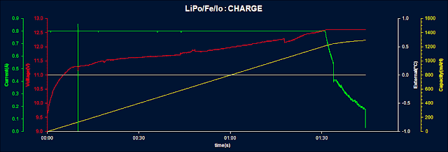

Here is a plot of the same 3S 1300mAh LiPo being Charged, at a charge rate of 0.8A (or 0.62C in this case):
The charger easily could have charged at a much faster rate (up to 6A or 80W Charge Power, whichever is limiting), but I chose to charge at a slow rate of 0.62C (0.8A for this battery) in order to approximately match the charge current to the 0.7~0.9A discharge current, which ultimately allows me to compare the charge and discharge curves, remove voltage hysteresis, and create an accurate plot of Estimated Resting Voltage versus State of Charge (% Capacity Remaining).
